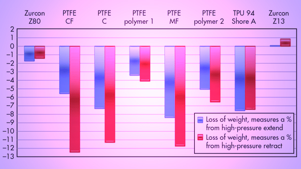

This chart shows loss of radial cross section of the seal ring in HFC fluid in two positions.

The design of rod seals was held constant across all materials tested, which included proprietary polytetrafluoroethylene (PTFE)-based materials with various fillers, proprietary polyethylene, and proprietary polyurethane. We measured the reduction in the radial cross-section of the seal ring (w-measure) and the change in weight to determine the wear rates.
Two test benches were used—one to measure wear and another to measure friction. In positions 1 and 4, the hydraulic pressure as a function of the piston rod direction was reversed to duplicate what would occur in a rod seal in a differential cylinder. Positions 2 and 3 duplicate the behavior of rod seals in a plunger cylinder.
Cross sections of four test samples after 200,000 test cycles show slight extrusion in the Zurcon Z80 material (upper left) and no significant material loss with Zurcon Z13, where as PTFE samples (bottom) exhibit substantial wear.
Pressure in relation to the direction of movement of the piston rod affects positions 2 and 3 and positions 1 and 4 differently. This leads to a difference in the lubricant film thickness, which has a substantial effect on wear rates. These relationships were confirmed when looking at weight loss together with dimension of the sealing profile contour. The PTFE-based materials show a greater deviation of wear dimensions.
The two materials that demonstrated the least weight loss (wear) were the proprietary compounds Zurcon Z80 and the Zurcon Z13. Measuring leakage from the cylinder showed that measurable leakage tended to increase at positions 1 and 4. No leakage was apparent only for seals made of the Zurcon Z80 and Zurcon Z13.
Visual inspection showed the best results were achieved with Zurcon Z13. Although the Zurcon Z80 showed slight extrusion after one million load cycles, no abnormality was observed with the Zurcon Z13 with the same seal geometry. The PTFE based materials were significantly worn after 200,000 cycles.
