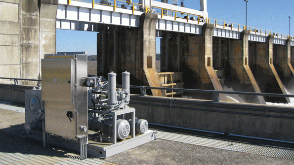

The new system design consists of four identical hydraulic power units placed at each corner of the lock and two stainless-steel electric operator consoles positioned on the east wall of the lock facing the water. Each power unit operates one 12-in. bore miter gate cylinder and one 11-in. bore water valve cylinder. Because the water valves were designed to allow a water rise rate of 10.25 fpm, continuous visual contact with boaters in the lock was mandatory. Another desired feature was to include redundant controls mounted on the front face of each power unit enclosure with a hinged, lockable stainless-steel cover. The cover protects the controls from the environment and can also prevent someone from operating more than one control station at the same time.
The power units were designed for outdoor service in all weather extremes. The top surface of the 250-gallon reservoir has a 5° slope to prevent water ponding. An immersion heater in the reservoir was sized to maintain oil temperature at 70°F during the winter months. The reservoir also contains magnetic separators, a level and temperature gauge, low oil-level switches, a dual-setpoint temperature switch, pump-suction shutoff valves, suction strainers, and desiccant breathers. Two Parker axial-piston pumps, a duplex high-pressure filter, and an in-tank return filter provide system redundancy. A drip pan with drain valve was also included.

A new motor-control center was installed to provide power distribution to the hydraulic units. Each power-unit enclosure contained pump-motor starters, an immersion heater contactor, a 60-A transformer for external lighting, a 30-A welding receptacle, a control-voltage transformer, and a PLC. Each electric motor was provided with encapsulated windings and winding heaters. System communication was accomplished using an Ethernet/IP fiber-optic ring network. It was imperative that logic be transferred between the power-unit PLCs for control and safety interlocks. Allen-Bradley produced the tag protocol that was utilized for the logic transfer.
A custom manifold contained all valving required to operate the miter gate and water valve cylinders and included: flowmeters, directional-control valves, counterbalance valves, cylinder-port relief valves, pilot-operated check valves and a high-speed/low-speed circuit. The high-speed/low-speed circuit consisted of a low-flow, pressure-compensated flow-control valve and a full-flow normally-closed DIN-style solenoid valve. When the high-speed valve is energized, full pump flow bypasses the flow control allowing full cylinder speed. Orifices in the DIN valve allowed smooth transition from full speed to low speed. Synchronizing two opposing gates during high speed was accomplished by visually adjusting the pump maximum volume stops.
The rear face of the manifold contained four-bolt flange ports for the cylinder connections. New stainless-steel welded pipe was installed between each manifold and the cylinders in the existing concrete trenches. Two stainless-steel ball valves at each cylinder location were provided to isolate the cylinder and a third bypass ball valve allowed the new pipe to be flushed prior to commissioning of the system. The manifold also contained several pressure test ports for system monitoring and evaluation.
