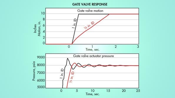

4. Simulation results of the closing sequence show ½ sec for the valve to close the 10-in. borehole. A significant pressure overshoot (circled) of 1,000 psi occurs from a water-hammer transient between the fluid supply and the control valve.

Simulations of the closing sequence, with results shown in Fig. 4, reveal that it only takes about ½ sec for the valve to close the 10-in. borehole. However, a significant pressure overshoot (circled in the figure) of 1,000 psi occurs from a water-hammer transient between the fluid supply and the control valve. Reducing the supply valve opening diameter did not significantly impact the overshoot. Placing an accumulator near the control valve would reduce the effect, but space considerations eliminated this option. Fortunately, parametric studies with the model showed that reducing the ID of the hose from 1 in. to ½ in. significantly mitigates the transient maximum pressure (the red curve in Fig. 4). It takes longer to close the gate valve with the reduced flow rate, but this was tolerable. As a side benefit, the smaller diameter hose was a significant cost saving. The simulation time on a standard laptop required only a few minutes for each case, so several design experiments could be run economically.
