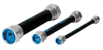

Almost everyone has observed that when flexible hoses are pressurized, they expand in the radial direction and contract in the axial direction. Festo Corp. exploits this phenomenon in a new type of actuator they call the Fluidic Muscle.
The design is relatively simple. Rubber core tubing is enclosed in two layers of material whose fibers are aligned in different directions to produce a rhomboidal pattern. Metal end caps are bolted on to complete the unit. When compressed air fills the tubing, it expands radially and contracts axially &emdash; generating very high axial force compared to a conventional pneumatic cylinder.
For example, a Fluidic Muscle with a 20-mm diameter develops as much force as a conventional cylinder with a 63-mm diameter at the same pressure. Both actuators develop a force of 1.5 kN at 6-bar, even though the cylinder has almost ten times the cross-sectional area and about eight times the weight. And the air consumption of the Muscle is correspondingly lower. Another comparison could be made between this 20-mm Fluidic Muscle and a 20-mm cylinder. This size cylinder can only manage around 110 N of force.
Comparing the force curves of the two types of actuators reveals another important difference. A cylinder delivers force over its entire stroke, while the Fluidic Muscle develops its full force only when initially stretched. This force decreases as a linear function of distance, petering out at around 20 to 25% of the Muscle's total length. Remember that the Muscle develops its maximum force directly from a neutral position. This makes the Muscle very suitable for highly dynamic applications, particularly if the stroke is short.
