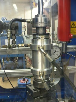

For the investigation of the wear behavior an endurance test rig was used, Figure 9. The following test parameters were used in the investigation:| • Pressure | p | 30 | [MPa] |
| • Temperature | T |
60 |
[°C] |
| • Stroke | s | 300 | [mm] |
| • Endurance | t | 250,000 | [cycle] |
| • Rod diameter | 50 | [mm] | |
| • Surface coating | chrome | ||
| • Medium | HLP 46 |
