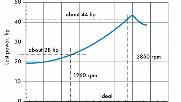

Figure 4 — The Lost Power diagram for the transmission shows significant power loss as motor output speed increases. (Click image for larger view.)

A program was written (LOSTNRGY.EXE) to determine the total energy lost in the loader’s hydrostatic transmission during an eight-hour work cycle. Using the probability histogram in Figure 4 and the Power Lost characteristic in Figure 1, it performed the summation shown in the green box.

Results showed that total lost energy for an 8-hr interval was 223 hp-hrs, an 11% reduction in lost energy when compared to the lost-energy calculation in Part 1. The energy reduction results from the operational histogram being a more harmonious match, efficiency-wise, than the long-trip process. This example problem does not take into account the other consequences of the shorter trip (e.g., more individual trips are made and more product is moved in the eight hours, but just not as far). This turns into more of a “black box” approach, looking only at the overall performance characteristics of the transmission and the statistical properties of the process.
