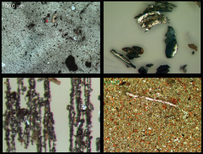

The Fluid Power Institute recently evaluated the contamination level of more than 100 new hydraulic components. This data set included hoses, tubes, fittings, valves, cylinders, pumps, and reservoirs. As can be seen in the graph, the contamination level in several new components exceeded 256 mg. This gives contamination a head start in attacking the hydraulic system at the beginning of its life.
The process of manufacturing components produces different types of contamination. Cutting a hose to length produces rubber and metal particles, as shown in the first photo. Machining a valve manifold produces cutting chips, as shown in the second photo. Welding the end caps onto a hydraulic cylinder produces iron oxide, as shown in the third image. Finally, fabricating a steel reservoir produces welding spatter in the form of molten metal, as shown in the final image. In all cases, post-processing must occur to prepare components for use in a fluid power system.
