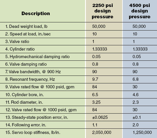

An example problem will help point out the differences: Assume you must move a 50,000-lb dead weight load vertically at 10 in./sec with a cylinder that has low-friction seals and very little other friction loading. The example is set up to compare the results when the power unit supplies a constant 2250 psig to those when the power unit supplies a constant 4500 psig. Optimal sizing technology has been applied to obtain the solution. The table shows the results of the two designs.
Table 1 — System performance compared when using two different system pressures to achieve identical force and speed goals in steady state
System comparison
The values in red are the design objectives, and the values in blue are the calculated results. This display ploy has been used to emphasize that in both cases — 2250 psi vs. 4500 — the force-velocity goals as well as other parameters are identical. In this way, we can easily see the effect only of changing the system design pressure.
Item 8 in the table is the key calculated parameter. With the lower pressure, the frequency is 9.7 Hz, but it drops to 6.8 Hz when the design pressure is raised to 4500 psi. There is about a 42% increase in the resonant frequency for having lowered the pressure. Many times this will mean the difference between a successful and a failed application.
Another important parameter is Item 15, the servoloop stiffness. Because it uses a position transducer and feedback control, it is generally believed that a servoloop is infinitely stiff. That is another misconception to be covered in a future issue. The proportionally controlled positional servoloop behaves like a spring. When the pressure is 2250 psi, the stiffness is 2 million lb/in. However, with the higher pressure, stiffness drops to about 60% of that value. The stiffness is a measure of the servoloop’s ability to hold its position against a varying load. The higher, the better.
Note also the positioning errors in Items 13 an 14. Item 13 is a measure of the servoloop’s ability to achieve a commanded position in steady state. With the lower pressure, it will find commanded position within 0.0625 in., whereas it can only find it within 0.1 in. with the higher pressure.
However, the added performance does not come for free. There is a price to pay that cannot be ignored. The price is in the valve size and the cylinder size. The cylinder bore is about 41% greater with the lower pressure. And because the goal with both pressures is to get 10 in./sec of speed, the valve flow rating goes from 30 to 84 gpm! This is not at all unexpected. After all, the purpose of using higher pressure is to make component sizes smaller.
In summary, the system designer must juggle some competing results. There has to be compromise between resonant frequency, component size, and cost. All too often, the higher pressure results in lower cost and — more often than not — lower weight components, and that is the final choice. However, if stiffness and resonance are limiting final performance, it may be necessary to downsize the pressure and upsize the cylinder and valve. It all depends on whether dynamic performance is more important than initial cost.
