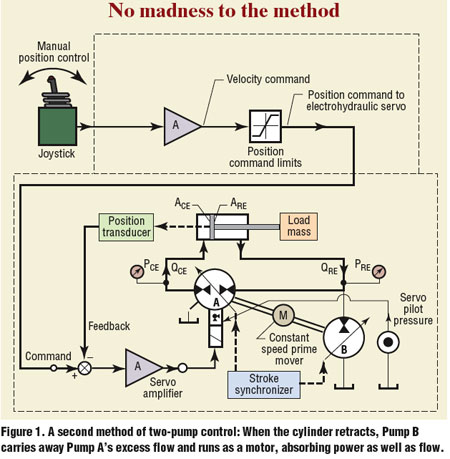

There are at least three viable configurations of the two-pump servo system. The first method was shown last month. In a second method, Figure 1, Pump B must supply makeup flow to Pump A when the cylinder extends. This means Pump A must be sized to provide cylinder cap-end flow at the design cylinder velocity. When the cylinder retracts, Pump A will have to absorb all the flow from the cap end, resulting in excessive fluid flowing toward the rod end.
This is where Pump B will function as an absorber, to carry away Pump A's excess flow. The rod-end pressure will be high (depending on the load), and Pump B will run as a motor, absorbing power as well as flow. The energy transmitted from Pump B's shaft will either be absorbed by the prime mover or sent into Pump A. This eliminates the energy losses that would otherwise occur if valves were used to control cylinder motion.
A third method just switches the pumps around so that the common pump connections are made on the cap end of the cylinder. This configuration offers an advantage: Pump A can be smaller than Pump B. This is because Pump A only has to be sized to provide rod-end flow at the maximum design speed — whether extending or retracting, whichever is greater. Pump B provides flow to the cap end during extension but absorbs the flow not needed by Pump A during retraction. For example, if the cylinder has a 2:1 area ratio, both pumps would be the same size with method two. With method three, Pump A would be twice as large as Pump B.

The preferred configuration of the electrohydraulic system provides a position-control servoloop: That's why all three configurations use a position transducer. The position loop aids setup — especially tuning of the system pressures.
As discussed last month, the ratioed stroke synchronizer mechanism keeps the pumps' displacements synchronized with one another, so the flows "add up." Each pump absorbs or issues flow as needed during a system cycle. Pressures are held in check by desynchronizing the displacements a fixed amount that causes flow from the two pumps to oppose each other. That is, the stroke offset input adjustment simultaneously causes one pump to stroke toward cylinder extension while the other strokes toward cylinder retraction. With the position loop closed, the command to stroke Pump A will cause both pump strokes to change in complimentary directions, and the cylinder will tend to stay in the commanded position.

What about applications in manually controlled, mobile equipment? The two-pump control adapts quite well to manual control — and with no reduction in the promised energy savings. Manual cylinder control normally involves deflecting a lever or joystick to control the direction and velocity of a cylinder. This is, essentially, a closed-loop position control — with the human operator closing the control loop.
Referring to Figure 1, if the operator shifts the joystick a fixed amount and holds it there, the pumps will stroke, the cylinder will extend, and it will stop when the feedback position coincides with the command. If the operator moves the joystick a little more, the cylinder will extend a little more — stopping, again, when feedback equals command.
This can be a useful system in the lift function of a fork lift, for example. The operator could set the joystick an amount that approximately sets the forks at, say, the height of a storage bay. Then, with a small thumbwheel on the joystick, he would tweak the position command to get the precise height, then proceed to remove or deposit the load.
But what about the situation where we want a conventional velocity command from the joystick? Can the control system of the two-pump circuit be configured so that the operator uses the joystick as a velocity control? Absolutely, but the modification does not change from a position loop to a velocity loop. Instead, the position loop is retained for all configurations. However, the controller is changed.
In the digital controller of Figure 2, the output of the joystick — normally a velocity control — is sent through four cascaded digital algorithms. The first is an artificial dead zone that the operator can set and tune for personal preferences. The second is an amplifier that scales the command to the proper level in a digital system. Next is a software integrator, the function of which is to convert the joystick output to a position control system.
The next step is a limit control that simply clips the maximum command to stay within the calibrated range of cylinder travel. In this system, if the operator moves the joystick some fixed amount, the integrator starts ramping up at a rate determined by the amount of joystick shift. The position servoloop then moves at that ramp rate in attempt to match the cylinder feedback signal to the command. Thus, the joystick appears to be a velocity controller to the operator.
