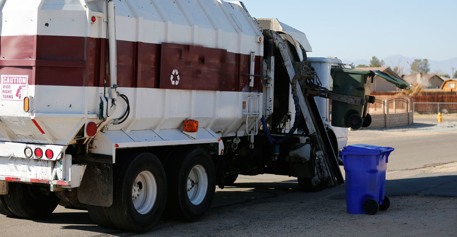

A Midwest-based original equipment manufacturer (OEM) designs and builds waste-receptacle dumpers that attach to garbage trucks, recycling vehicles, and other waste-handling equipment. The lifter is attaches to the front or side of a vehicle or onto the dumpster of a front-load refuse truck. After an operator positions a receptacle cart onto the dumper, the latter then lifts and tilts the cart, spilling its contents into the vehicle. When the dumping cycle is complete, the lifter returns to a stowed position.
