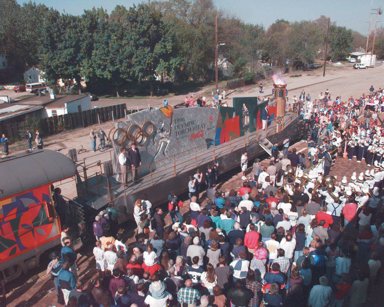

To cover 11 segments in western regions of the journey, a 19-car passenger train carried the flame for more than 3500 miles. Union Pacific Railroad provided the passenger train, which included a custom-built Cauldron Car (Fig. 1). The car features an open cauldron containing the Olympic flame. At the beginning of each segment, the torch — carried by an Olympic runner—lights the flame on the Cauldron Car. Before departure, a hydraulic drive lowers the cauldron for safety and to help prevent wind from blowing out the flame while the train is in transit. In the lowered position, the top of the cauldron is 12 ft 8 in. above the top of rails. With the train stopped, the cylinder can raise the cauldron to a height of 15 ft 8 in. When the train arrives at its destination, the hydraulic drive raises the cauldron to provide onlookers with an unobstructed view of the famous flame. The next Olympic runner then transfers the flame onto his or her torch from the cauldron and resumes the journey on foot.
1. The Olympic Cauldron Car pauses for trackside ceremonies in Boise, Idaho on May 9. A hydraulic drive raises the torch (as it is here) for all to see when the car is stationary and lowers to torch for safety and to keep it from being extinguished by wind when the car is in motion.

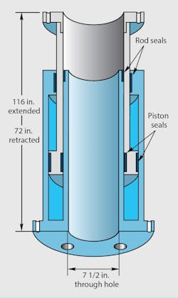

3. Sectional view shows internal workings of a hollow-rod cylinder that had to be designed, constructed, and tested within a 3-week production schedule.
The cylinder itself (Fig. 3), has a 7½-in. through-hole to accommodate service lines supplying the cauldron itself. Limit switches provide signals to the controller to indicate when the piston rod has extended or retracted to its final position. This simplifies control by stopping the cylinder automatically, so an operator simply has to push a raise or lower button to place the cauldron in the desired position.
