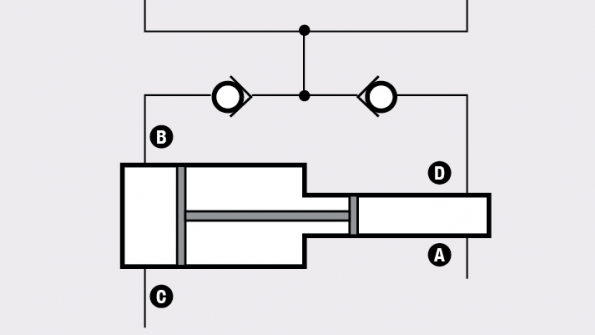

We rigged up a strange-looking but effective atrrangement to power a vertical, 200-ton sand-squeezing press in one of our foundries. The application required a 36-in. main ram to rapid-travel for about 18 in., the squeeze at 4000 psi for about 4 in.
We didn't have pumps with the pressure or flow capacity to drive the ram like that, so we combined two 10-ft stroke cylinders — one with  a 16-in. bore and one with an 8-in. bore —onto a common piston rod to create a 20-ft long, 2-way intensifier.
The pumps that were available could supply 100 gpm at 1000 psi. Applied at Port A, this flow and pressure pushed 400 gpm at 250 psi out Port B for rpid travel. When the pump flow was applied to Port C, we got 25 gpm at 4000 psi from Port D to generate the squeezing force. We had a 4:1 flow multiplier in one stroke direction, and a 4:1 pressure intensifier in the other.
The complete circuit to control the press was fairly complex, but it consisted mainly of small pilot valves operating larger pilot-operated check valves. This made it easy to maintain.
