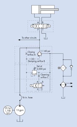

Solenoid-operated relief valves typically contain three orifices. The main pressure line flows through an orifice, A. From there, oil either leaks to the top of the main poppet, causing it to close, or drains to the tank, allowing the main poppet to open at 4 bar of pressure. This orifice normally determines the closing speed of the valve. A partial blockage in this orifice slows pressure buildup. The orifice acts like a flow control that controls the main poppet closing speed. Technicians found Teflon tape obstructing the orifice, thereby causing the delayed closing speed. Removing the obstruction solved the problem.
