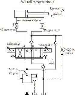

Technicians tried to solve why the cylinder of a temper mill's roll-removal system was struggling with heavier rolls.
A temper mill had a roll-removal system that operated at the proper speed but had difficulty moving large rolls off the production line. A hydraulic cylinder extended to remove the roll and was controlled by a regenerative circuit to achieve fast, slowdown, and approach speeds. The regen circuit used a pilot-operated proportional valve; its pilot connection was fed by a pressure-reducing valve that limited pilot pressure to 572 psi. The pressure at the connection had been verified.
The system could move rolls weighing up to about half the rated capacity, but struggled with any rolls that were heavier. They checked the cylinder piston for leakage by shutting the cap-end ball valve while the cylinder was about half-way extended. Then they pressurized the rod end of the cylinder to see if it extended, which would indicate leaking piston seals. If it locked up, the seals were good. However, you have to leak all of the supplied flow across the piston for pressure to drop—a fact overlooked by many technicians.
The electrical maintenance technician was asked to examine the feedback signal to make sure the valve spool was responding, and it was according to the technician.
Any idea why the cylinder couldn’t move the heavy loads as intended?
