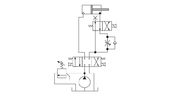

A casting plant used a simple two-speed circuit to extend a hydraulic cylinder at high speed, then shift to a slower speed for forming. The maintenance supervisor used the accompanying schematic to plumb the circuit.
Dec. 19, 2014
3 min read
A problem occurred when the cylinder shifted to low speed—the nesting of the steel stamping bounced out of alignment with a hole bored in the fixture. Shifting the two-position directional valve, B, to slow pressing speed produced a jolt and a pressure spike, which caused unwanted movement of the stamping.
Maintenance personnel purchased and installed a soft-shift directional valve with a 500-ms shifting speed, but it made the problem worse.  They re-installed the original directional valve, A, and installed a pressure gauge in the piping between the cylinder’s rod end and the two-position valve. The cylinder had a 5-in. bore and a 3½-in. rod diameter. They were surprised that the pressures jumped from 350 psi during fast advance to 4,000 psi when the slow-speed meter-out flow control was selected. The pump compensator was set at 2,000 psi.
Any idea what caused the problem?
