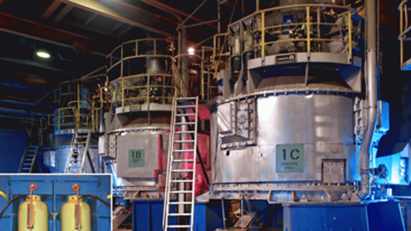

The operating conditions in the coal pulverizer are harsh. Coal dust and vibrations cause high levels of wear to hydraulic components. Photo courtesy of FTL Seals Technology

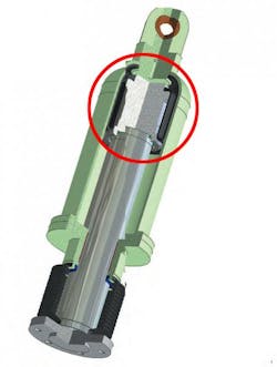

Cross-section of a coal pulverizer pressure cylinder. The rolling lobe air spring (labeled) movs the piston rod attached below. Illustration courtesy of ContiTech
