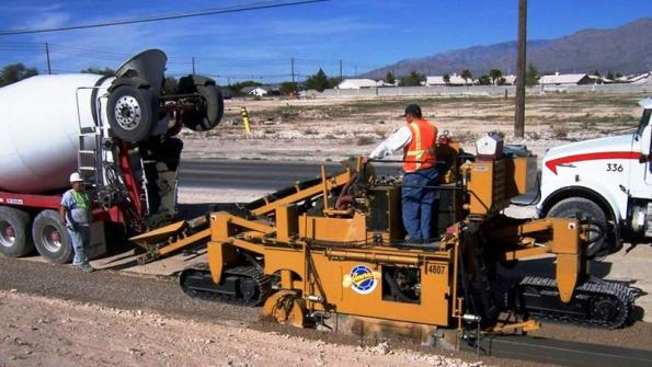

The Easi-Pour in action
The Easi-Pour Compact 880 pours barriers to 42 in. high, paves up to 8 ft widths, and handles any tasks that fall in between these specifications. After an accompanying transit mixer pours concrete mixture into its conveyor hopper, the Easi-Pour’s auger moves material across the machine to a slipform mold that’s located at road level. As the paver travels forward, a hydraulic vibrator helps shape the concrete in a mold, guided by a stringline sensing system also manufactured by Huron. The stringline system automatically ensures perfect steering and grade by incorporating five sensors — two steering, two grade, and one cross-level control. The 880 machine also comes with a grade trimmer with a standard width of 51 in. to trim high spots from the road surface.
Overbuilt’s Easi-Pour matches up well against industry alternatives. In addition to the tighter turning radius, this low-profile machine provides the operator excellent visibility of all the machine’s operations. It features the industry’s largest concrete hopper, yet requires no breakdown for transport. All Easi-Pours feature 4-leg stability, and all legs are capable of hydraulically ‘sliding’ to accommodate essentially any paving configuration. Most importantly, safety, durability, and long life are engineered into every Easi-Pour.

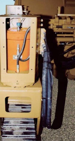

Overbuilt Paving and Mining replaced the previously used steering cylinders with Helac Corporation’s sliding spline rotary actuator technology to solve the issues that were inherent with the hydraulic cylinders.
The cylinders offered a turning radius of only 60° — 30° left and 30° right — compared to the 180° of rotation offered by the rotary actuator. The former steering configuration also required multiple mechanical linkage components that needed to be machined and welded together, which is inherent to this type of design. The rotary actuator technology offers a cylindrical housing that contains all moving parts safely inside. The rotary actuators not only became the steering unit for all four tracks, but provide the support of the load and the hydraulic turning power as well.
Overbuilt Paving and Mining. also had maintenance and machine performance issues with the steering cylinders from all the pivot pins and also the pins to keep bearings mounted between caster plates. Its machine operators needed to make sure the pins were kept tight, and the bearings had to be greased regularly. The machine wouldn’t operate properly if the pins holding the bearing loosened. Helac’s bearings, seals, and torque-generating elements all are completely sealed and lubricated by the hydraulic fluid inside the actuator housing, resulting in low maintenance and zero leakage.
The use of mechanical drives — chains and linkages — with the cylinders also limited the vertical and horizontal positioning of the tracks. However, the rotary actuators provide steering feedback through a transducer mounted at the end of each actuator.

The torque output generated by Helac’s L30 Series actuator gave the Easi-Pour machine the power to make much tighter turns than many comparable machines in the industry. The quality of the pour also improved because the height of the drive tracks could be independently controlled without impacting the steering capability.
Serfling concludes, “The rotary actuators we are using to steer the front two tracks 180° are Helac’s L30-95-EFF- 180 product model. The back two tracks use the same product model, but they’re fitted with an internal stop to limit rotation to 100°.” The actuator supports 10,000 lb of thrust and provides 261,250 lb-in. of moment capacity. Steering torque is 55,000 lb-in. at 2,000 psi when fully loaded.
