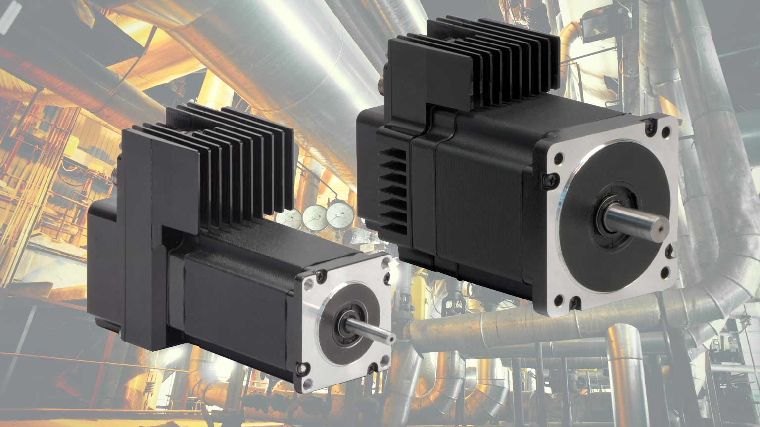

There is also a new type of motor being used: the hybrid stepper. The ServoStep motor offers the benefits of steppers and servos by having some characteristics of both. They provide a closed loop on the stepper motor to get some of the advantages of the servo control.
