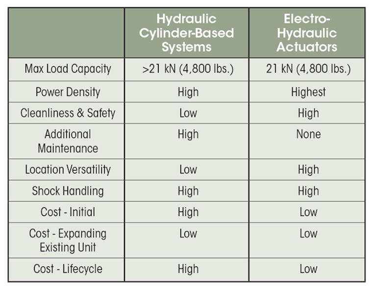

For loads up to 4,800 lb, a compact electro-hydraulic actuator has the advantage over hydraulic cylinders in terms of power density, maintenance, location versatility, cleanliness and cost, while still handling comparable shock loading.
Self-contained electro-hydraulic actuators require no maintenance. Hydraulic cylinders, on the other hand, require constant fluid servicing. And as they age, they begin to wear and leak around the piston. Pumps and other components also wear over time and develop internal leaks and pressure losses.
Engineers have more design flexibility when positioning electro-hydraulic actuators. They do not need elaborate support systems, so they can be more easily placed so that control is closer to the point of application and accessibility is also improved.
For example, it’s easier to run electrical wire than hydraulic lines up the boom of a cherry picker or run an electric cable from a tractor to a towed planter to control seed depth instead of hydraulic lines. In both cases, overall system size is reduced along with the risk of leaks.
Hydraulic cylinders are adept at handling sudden shocks, such as when a cylinder-guided plow hits a snow-covered barrier or a mower deck runs into a large rock. They absorb sudden energy spikes instantly by redistributing fluids throughout their internal valves and pump housing. Electro-hydraulic actuator shock resistance is on par with that of hydraulic cylinders.
Thomson Industries
An H-Track actuator from Thomson Industries in its extended position.
Conventional hydraulic systems can be most cost effective when adding extra cylinders to a design that already contains other hydraulic elements. Otherwise, the cost of incorporating the necessary support system must be considered. Electro-hydraulic actuators eliminate fluid handling and storage, leak and spill management, and the additional maintenance costs of identifying and repairing leaks, which reduces lifecycle costs for end-users and provide benefits that OEMs can market to their customers.
