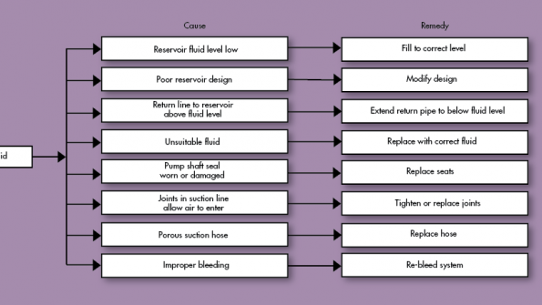

Technically, excessive vibration is a mechanical, not a hydraulic problem.  In a well-designed hydraulic system, vibration is neither identified with nor related to the shifting action of hydraulic controls, the linear movement of cylinders, the rotation of pumps and motors, or the oil itself.  Yet, mechanical imbalance – which results in vibration – can and often is the cause of hydraulic problems that maintenance people must troubleshoot and deal with.  A detailed troubleshooting procedure for excessive vibration appears in Figure 7.
Figure 7 – Pinpointing causes of vibration problems. Click on image for larger view.Long-term consequences — The trouble is that engineers often tend to design to resolve an immediate problem, but frequently fail to consider the longer-term consequences of their designs.  One example of lack of design foresight is component inaccessibility on many machines.  Replacing a pump and achieving the required alignment of electric motor and hydraulic pump – to avoid vibration – in a machine is often difficult and sometimes nearly impossible if electric motors and pumps are buried inside the machine.  The initial assembly is made without problems, but after other machine elements are in place, maintenance, repair, and replacement becomes a headache.
