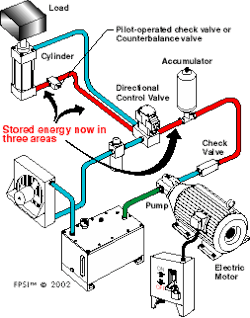

A rod seal on a vertically mounted hydraulic cylinder was leaking, and to work on the cylinder, a mechanic followed what he thought were all the necessary safety precautions. He shifted the directional valve to fully lower the load, de-energized the hydraulic power unit, and locked the power unit out according to company policy. He then loosened the fitting on the cap-end of the cylinder, and, to his surprise, a high-velocity jet of hydraulic fluid shot out of the fitting.
The mechanic assumed that lowering the load to a rest position dissipated all pressure in the hydraulic line he was working on. Sounds logical to me. But McLaren explains that a counterbalance valve in the line between a cylinder and directional control valve can become a pressure trap. Consequently, the pressure setting of the counterbalance valve is the lowest pressure in the line when the machine is shut off—even if the cylinder is at the rest position.
In this case, the pressure setting of the counterbalance valve was 1200 psi (83 bar)—more than enough stored energy to launch a lethal shot of oil. The mechanic was injured by the accident—and could’ve been killed. What he should have done was verify that all hydraulic lines were depressurized before opening any of them to atmosphere.
Suggestions on how to prevent this type of accident*
Figure A
1. Make safe and verifiable de-energization the focus of system design. The design must include a means of safely removing any and all "pockets" of potentially hazardous hydraulic energy, Figure A. In addition, if a possibility exists for re-accumulation of stored energy to a hazardous level, continue verification of isolation  until the servicing or maintenance is completed or until the possibility of such accumulation no longer exists.

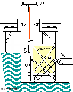

5. Have lockout and de-energization drills to ensure that personnel know exactly how to make a machine safe to work on; some lockout situations are complex because someone might need to lock out numerous machines to make the situation safe. Refer to Figure B, which illustrates an actual machine. Routine maintenance and repair have to be carried out in area A. To lock the machine out safely, it is necessary to lockout mechanisms 1, 2, 3, 4, and 5 individually. Failure to do so could result in severe injury or death. It would be wise to have periodic lockout drills on these types of machines. Telling maintenance and service personnel how to conduct the service or repair in a classroom setting is one thing, doing it under the demanding pressures of a disabled production machine is another. When it comes to safe lockout, there is absolutely no room for error!
