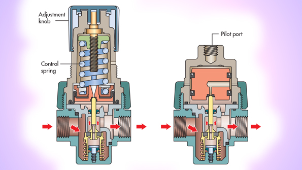

Illustrations show interior design of regulators: manual-operated, left, and pilot-operated, right.

The next choice is to select an adjustment style: manual or pilot-operated, as shown in the illustrations. Manually operated units use a control knob or T-handle to adjust the regulator’s output pressure. The non-rising control knob is the most common style used today because of its compact size and styling. The T-handle version is the more traditional style and is more commonly found on heavy-duty equipment.
A pilot-operated regulator simply replaces the standard control knob and spring with a pilot chamber. A small external regulator supplies a control pressure to the pilot chamber. Because most pilot-operated regulators have a 1:1 ratio of pilot pressure to output pressure, a pilot pressure of 100 psi would deliver 100 psi out of the main regulator.
