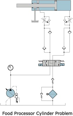

Can you determine why a rod-end meter-outflow control was overheating and what the best solution to fix it would be?
In the food processing industry, extra care is taken to ensure hydraulic oil does not find its way into the product. The circuit shown is one that had air causing the cylinder to drift, creating a problem with the autocycle sensors. Notice the extra rod-gland drain line. It lets operators see if the seal was leaking and replace it before it became a problem. The long lines with 50-psi check valves were used to make sure oil leaving the cylinder returned to the tank for filtering and fresh oil was making it to the cylinder. The production line was on the first floor with the power unit in the basement
Recently, the customer had a problem with the rod-end meter-outflow control getting so hot the paint was peeling off it. The maintenance crew was new to this part of the plant and did not know much about the original design. After a new flow control did not fix the problem, their next solution was to install a heat exchanger.
Any idea what caused the overheating?
What’s the Problem?
