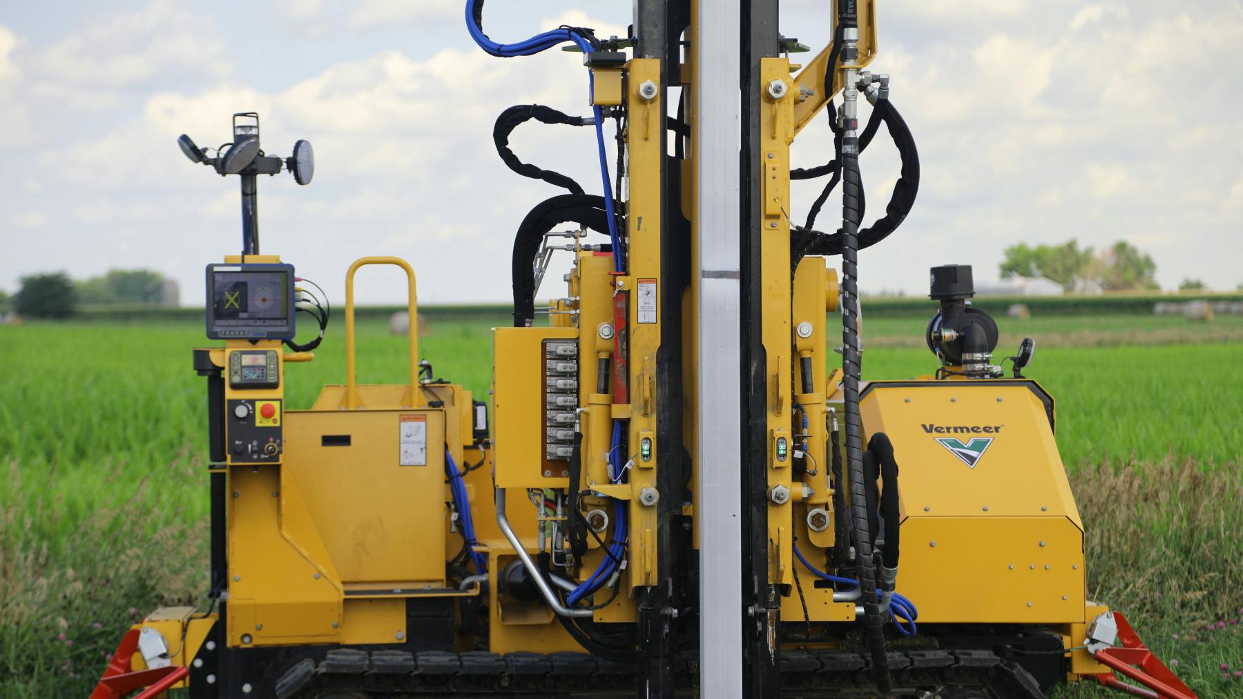

Incorporation of sensors into hydraulic cylinders can help them move in a more precise manner, enabling improved accuracy and the ability to automate machine movements. These capabilities were demonstrated when Rota Limited worked with heavy equipment manufacturer Vermeer on the development of its PD10 pile driver for solar field installations.
A high level of accuracy is required when driving the piles used to support solar panels into the ground during a solar field installation. Understanding this, Vermeer contacted Rota about integrating its linear position sensors into two of the PD10's hydraulic cylinders. Adding the sensors would help to ensure accuracy when driving piles into the ground as well as help to automate this typically difficult and repetitive task.
Piles need to be driven into the ground 10 ft. apart, at just the right angle, thousands of times a day during a solar field installation. “[This is] a very repetitive process that really needs to be automated and [cohesive] so there is a nice, feng shui look of the solar panels when you’re done,” said Jake Hewes, PMP, International Sales Manager at Rota Limited.
With the Rota sensors, Vermeer was able to design the PD10 so operators could more easily install piles at the correct location, depth and angle to achieve the accuracy and aesthetics desired by the project at hand.

Two different types of Rota sensors were used in the PD10. The initial goal was to embed them in the machine’s hydraulic cylinders to protect the sensors from the shocks and vibrations that would likely be experienced in this application.
One of the sensors is embedded in a hydraulic cylinder used on the substructure of the pile driver. Hewes said keeping the pin-to-pin dimensions of a hydraulic cylinder unchanged can be difficult when embedding a sensor. “A lot of times the cylinder will need to grow in length to add a sensor,” he explained. “Because our technology is Hall Effect and fits in a small package, it allowed us to fit one of the sensors in the cylinder without increasing the pin-to-pin [dimensions] which was key to fitting it underneath this machine.”
The second sensor in the mast of the machine is an independent mount sensor. While Rota had a solution which could be embedded into a hydraulic cylinder, its location made it difficult to run necessary wire harnesses or connectors without them getting damaged. “The solution was to remove the sensor from the cylinder and bolt it in parallel with the cylinder a safe distance away from it where we could run the wire harness safely through the machine to prevent it from being damaged in the field,” explained Hewes.
For this sensor, Rota used a heavy-duty stainless-steel version to ensure it could withstand the high-vibration environments in which the pile driver would be working.

The PD10 features an integrated control system, providing operators with a range of machine information such as pile angle, height as well as maintenance needs, much of which is possible because of the inclusion of the position sensors in the hydraulic cylinders said Hewes. Providing operators with easy access to this information helps them to stay on task and ensure they are installing the piles as desired by the project at hand.

With this capability, automated functions can be added to a machine as Vermeer did with the PD10. An auto plumb feature on the pile driver automatically moves the mast to a plumb orientation with a simple push of a button which Vermeer says can reduce cycle time – aiding overall productivity and efficiency of an installation. This also makes the task easier for operators, an increasingly important aspect with construction equipment of all types due to the lack of skilled labor entering the industry.

Hewes noted Vermeer actually offers two versions of the PD10 pile driver; the PD10R model has no operator cab but instead enables wireless remote control of the machine. All other aspects, including use of the Rota sensors, are the same as the original PD10 pile driver but with the ability to remotely operate the machine as a means of further improving ease of use and solar field installation efficiency.
