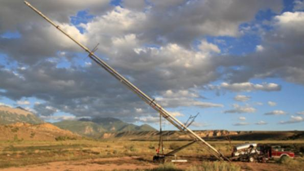

The Big 10 Inch (BTI) pneumatic cannon holds the Guinness Book of World Record for launching pumpkins over a mile at speeds that approach the local speed of sound. It is set to compete again at the World Champion Pumpkin Chucking (that’s pronounced “Punkin Chunkin”) competition this year. The BTI set the record in Moab, Utah in 2010 by launching a 9-lb, 12-oz Las Estrellas pumpkin over a distance of 5545.42 ft.

The pumpkins exit the 100-ft. cannon at speed exceeding 1000 feet per second, or 680 miles per hour. It uses a two-stage 3000-lb. ASME-code pressure tank run by a 25 horsepower motor that compresses air to 300 pounds per square inch. When decompressed, this runs a refrigeration cycle that builds ice around the exit of the compressor.
At such high speeds, the pumpkin are subjected to about 500 G. Team leader, Ralph Eschborn,puts this into perspective by saying pilots black out at about 6 or 7 G, while 50 G can kill someone in a car crash, and 501 G makes pumpkin pie-- which means that the pumpkin explodes upon exiting the cannon. With a 10-lb. pumpkin approaching speeds close to the speed of sound, the momentum transfer to the system is enormous.
