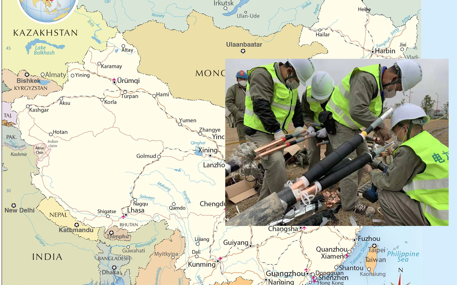

As the coronavirus overwhelmed Wuhan in China’s Hubei Province in January, Eaton experts were part of the team that delivered a new healthcare facility in just 10 days. Howard Liu, president of the Asia-Pacific region for Eaton’s electrical sector, and Robert Stroescu, vice president for light commercial and construction at Eaton, discussed with Hydraulics & Pneumatics how the company responded locally to meet the extraordinary demand, how they worked to build a hospital and keep their own workers safe, and what we have already learned from this pandemic that may help in the future.

Our teams coordinated with several distributors to consolidate inventory to deliver products to the Huoshenshan Hospital. When our engineers had difficulties getting onsite for [uninterrupted power source] commissioning, the team improvised and instructed successful commissioning via video conference.
