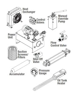

If the hydraulic system leaks, the hydraulic oil can be time consuming to clean up and could cause potential environmental concerns. There is also the potential for safety issues if oil contaminates manufactured products.
All the components required by a hydraulic system necessitate a larger footprint in a manufacturing facility, as well, which can be difficult to accommodate if space is at a premium.

A hydraulic system typically requires routine maintenance to change the oil and filters in order to ensure continued performance. It may also be necessary to replace fittings, valves or other components over time.
