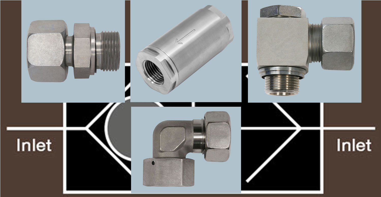

Both male and female versions of metric DIN 2353 24-deg cone fittings have straight metric threads. The tube OD is mated with a 24-deg seat, recessed counter-bore of the male fitting. The female mating component can be a metric DIN 2353 female tube fitting, a metric tube with a cutting ring and nut, or a 24-deg cone with an O-Ring either welded or end-formed onto metric tube. The seat angle should be measured from the fitting centerline using a 12-deg gauge. The sealing of the two components is between the 24-deg seat in the male end and the corresponding female end.
The 90° elbow DIN 2353 fitting pictured on the left has a male thread at the bottom and female at right.
A metric standpipe fitting is made of three preassembled pieces: a bite sleeve, nut, and the standpipe. Standpipe fittings are usually specified for harsh environments, such as high-temperature and aggressive fluids which might destroy soft seals. Agricultural machines often use standpipe fittings because of the frequent use of caustic and corrosive fluids.
Adjustable standpipe fittings facilitate the connection of a metric tube with a 24° conical bore. Tightening the nut onto a DIN 2353 male connection, compresses the bite sleeve onto the tube of the standpipe, which establishes the seal.

A check valve, sometimes referred to as a non-return valve, is a spring-loaded valve used in liquid systems where the flow should only go in one direction and safeguards from back flow. These valves can be installed inline and look very much like a large fitting. Because fluid can flow in only one direction, the outer body usually has an arrow pointing in the direction of flow to aid proper installation.
Check (non-return) valves are to allow fluid flow in one direction only. The check valve shown here has an arrow to indicate direction of flow.
Metal sealing surfaces will typically allow some leakage. Therefore, where zero leakage is required, especially when gas or certain hazardous chemicals are being transferred, Buna-N, Viton (FKM), or another elastomer is used to provide a leak-tight shutoff.
A shuttle valve (known in Europe as an alternating valve) is T-shaped and allows flow to pass from one of two inlets to an outlet port. An internal floating ball blocks flow from one inlet port or the other. The port with fluid at the lower of the two pressures will always be blocked, and fluid from the inlet at the higher pressure of the two will always flow to the outlet.
This ISO symbol of a shuttle valve shows how a ball allows flow from only one inlet or the other to flow to the outlet.
The ball in an alternating valve provides metal-to-metal contact with a resilient seal seat to ensure a leak-tight shutoff of liquid or gas. However, they should not to be used with weld nipples, swivel nuts, or any connection that does not allow contact with a shoulder stop in the inner cone. Typical end connections are 24-deg flareless shuttle valve tube style.
