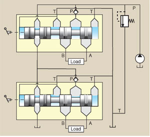

In continuing the discussion from last month, the partial series connection derives its name from the fact that the return flow from the load actuator does not recombine with the upstream bypass flow before supplying the downstream functions. Instead, the return flow from each 4-way valve section is sent directly to tank. Only the bypass flow from upstream functions is used to power the downstream functions.
Figure 1. The cutaway diagram shows that it is only the bypass flow from upstream functions that go to power the downstream functions.
The connections are illustrated in the cutaway diagram of Figure1. Notice how the bypass connection between sections connects through the transition check valve to the pressure port of the second section. An important feature of this valve type can be seen when you consider what happens if you fully shift the upstream spool: the upstream bypass flow is completely cut off, and there is no flow available to the downstream functions. Simultaneous operation of more than one function is limited to those conditions when only partial shifting of the upstream functions occurs.

In the interest of completeness, the ISO conventional schematic is shown in Figure 2. In this figure, again, the partial series feature can be seen as the connection between each of the two 4-way return ports and the internal tank connection. Also, clearly shown, is the bypass connection that supplies fluid to all the downstream functions. Equally clearly, it shows how downstream flow is cut off in the event of full shift of an upstream function.
Figure 2. Conventional ISO schematic diagram of the partial series, two-function, open center stack valve.
