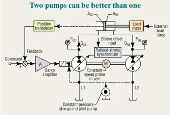

Single-rod cylinders can be actuated efficiently and accurately by using two synchronized pumps with displacements matching the rod- and cap-end volumes of the cylinder. The problem with valve control of cylinder motion ...
The problem with valve control of cylinder motion is that it does its work by converting (consuming) unused power to heat in the hydraulic fluid. The advantage of valve control is that it accommodates differential rod- and cap-end flows. Pump control, on the other hand, is efficient because it can deliver power only when and where it is needed. The disadvantage is that it works best with equal area actuators, and works not at all with unequal area actuators.
Attempts have been made to use pump control on single-rod cylinders. However, they incorporated some form of valving to deal with the unequal flow, thus introducing an inefficiency. The simplified schematic shown here depicts pump control without any valves, except those needed to control the displacement of the two pumps. This system is called the two-pump control method, and it uses a pump on each end of a cylinder. Put simply, the two pumps have displacements that are matched to the respective cylinder areas. To extend the cylinder, pump A displacement increases to route flow into the cap end of the cylinder. At the same time, displacement of pump B increases to absorb flow from the rod end of the cylinder. Obviously, pump B's displacement must increase at a lower rate than pump A's. This is the function of the block labeled Ratioed stroke synchronizer.
Suppose the cap-end to rod-end area ratio of the cylinder is 2:1. The synchronizer is a mechanism (electrical, hydraulic, or mechanical) that causes pump A's displacement to be twice that of pump B's. If pump A displaces 4 in.3/ rev, pump B will displace 2 in.3/ rev. Clearly, the pumps must be capable of over-center operation. The least expensive means for displacement synchronization would be a simple mechanical linkage between the two pumps. However, the most flexible solution would occur with computer control.

The circuit in the illustration has the equipment connected in a closed positional servo loop. Preliminary adjustments will set the two displacements at zero when the cylinder is unloaded and not moving. The two cylinder pressures will both be zero, or nearly so. This results in a lack of stiffness in the servo loop — a condition that must be corrected. When the cylinder is at rest, adjusting the offset control causes the displacement of one pump to increase. If this is done to the rod end, fluid from pump B will tend to retract the rod. However, if the piston rod actually does retract, the position loop takes over and increases the displacement of pump A to push the rod back.
The result is that cylinder position is almost completely maintained. However, the pressures at both ends of the cylinder are now elevated. In a 2:1 area cylinder, and with the cylinder at rest with no load, the offset would be adjusted so that the rod-end pressure would be about 2⁄3 of the maximum anticipated pressure, and the cap-end pressure would be about 1⁄3. The elevated pressures deliver the desired stiffness. In fact, it is the same stiffness that contributes to the success of a valve-controlled servo loop. The next step is to tune the displacement ratio synchronizer.
Tuning the synchronizer
Again, the system is to be adjusted with no external load on the cylinder. A command signal is generated — either manually or by some automatic means — to cause the cylinder to extend and retract slowly enough to enable reading and interpreting of the two cylinder pressures. Once the proportioning mechanism synchronizes the two pumps' displacements, the two pressures will change very little as the cylinder extends, retracts, and stops.
To visualize this, imagine a command is given to extend the cylinder, and the displacement of pump B is increasing too rapidly in comparison to that of pump A. Pump B's displacement is moving too much fluid. We would expect pump B's pressure to fall, but so would pump A's. When the cylinder motion is reversed, an excessively high pump B displacement would cause both pressures to increase.
Just the opposite pressure changes will occur if pump B's displacement changes too slowly, or if pump A changes too rapidly. So now the tuning strategy is simple: Adjust the ratio for synchronization until the changes in cylinder pressures between extension, retraction, and stopped are minimized. This will require some judgment because the pressures will not be constant.
