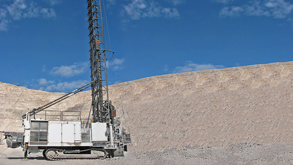

1. This mobile blast-hole rig relies on hydraulics for most of its operations and a diesel engine for power. Diesel engines have always produced high torsional vibration from heavy pressure pulses, which are even more pronounced in Tier-4 engines.
