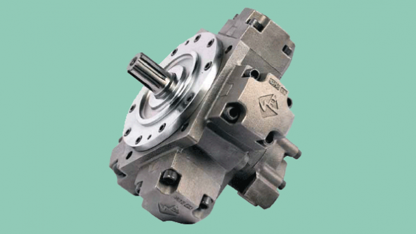

YITM series of hydraulic piston motors features a roller bearing between the piston and crank, permitting high torque efficiency and smooth operation. “Hydraulically balanced’ distributor ...
YITM series of hydraulic piston motors features a roller bearing between the piston and crank, permitting high torque efficiency and smooth operation. “Hydraulically balanced’ distributor delivers a very high volumetric efficiency. They are available in 16 frames and 59 displacements ranging from 64 to 16,000 cc (3.9-980 in.3) and torques from 168 to 34,250 lb-ft. Series is rated for pressures to 3600 psi.
Young Powertech Inc., (888) 465-3561
