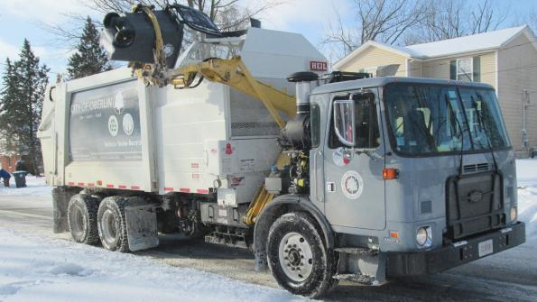

But renting trucks was a temporary solution, so when officials met to devise a permanent solution, leadership recommitted to its zero-waste policy. As a result, they decided to replace the fleet with hydraulic hybrid trucks. The action came from joint efforts between the city of Oberlin, Oberlin College, and the Ohio Environmental Protection Agency to obtain three new collection trucks using the RunWise hydraulic hybrid drive system from Parker Hannifin Corp. As part of this commitment, Oberlin received a grant of $200,000 from the Ohio Environmental Protection Agency to replace the fleet with the hydraulic hybrid trucks. Funds were also proved by the Green Edge Fund at Oberlin College.
Hydraulic hybrid operation
The RunWise system in the Oberlin trucks uses three Parker C24 pump/motors. The C24 is a bent-axis piston pump/motor featuring several proprietary design and construction characteristics for this application. One pump is driven by the truck’s engine for pressurizing the system. Each of the other two is connected to a rear wheel drive to capture braking energy to decelerate the truck and to accelerate the vehicle using the stored energy. Other key components of the system are accumulators that capture and release braking energy.
In essence, when the driver depresses the brake pedal, the two rear pump/motors act as pumps by transmitting the kinetic energy of the moving truck into hydraulic power. This energy conversion decelerates the truck, and the hydraulic energy is stored in the accumulators. When the driver then depresses the accelerator pedal, the hydraulic energy is released from the accumulators to drive the pump/motors, accelerating the truck.
