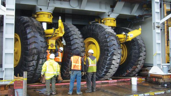

Self-propelled wheel drive modules feature a speed range of 100 ft/hr to 2.5 mph and also provide hydraulic steering and braking for transporting loads to 25 million lb. Click on image for larger view.

Hydrostatic pump powers wheeled drive system
Hydraulic power unit for a mobile wheeled moving system. Click on image for larger view.
In 1997,” notes Scott Van Raden, “our redesign of the drive system for our self-propelled wheeled systems incorporated the Parker Gold Cup hydrostatic transmission. The jacking and steering system incorporated Parker PV series piston pumps, and a Parker vane pump was designed in for the braking circuit.”
An HPU and high-pressure hydraulic system is used to propel these 50-ft. wide by 100-ft. tall rig-mounted modules that have tires 12-ft. tall and 4-ft. wide mounted on wheels bolted to Columbia drive axles, each with a maximum capacity of 680,000 lb. Total carrying capacity for a self-propelled wheeled module is about 2.5 million lb. Each module is powered by a diesel-driven generator that supplies power to electric motors of the hydraulic power unit. Module steering and braking is controlled by an operator from a cab on the front. If necessary, each axle can be turned 90° to drive the configuration sideways.
“The low-pressure piston pump system used for jacking and steering,” Van Raden explains, “has a maximum of 1650 psi for the jacking circuit and 2000 psi for the steering circuit. Each circuit has separate pumps.”
“With a 5000-psi Gold Cup hydrostatic pump,” continues Van Raden, “the drive system gives us forward and rearward travel with speeds up to 212 mph maximum, and down to an absolute dead creep speed of 100 ft/hr. Such a slow speed is needed as the drilling rig module approaches the well to ensure that the center of the drill pipe is directly on the well center to be drilled. Placement accuracy has to be within 116 in.
“The Gold Cup pumps have a built-in charge pump, which provides the required replenish/flow pressure to the closed circuit transmission,” Van Raden stresses. “Plus, visual indicators mounted on the outside of the pump and motor cases allow our technicians to see if the internal components of these mobile units are following the control signals sent to them. This makes it considerably faster and easier to troubleshoot any problem that might arise. Finally, we continue to use Gold Cup pumps for our wheeled systems for their proven service and reliability record.”
