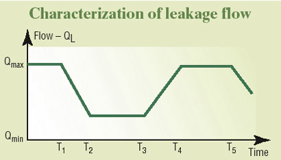

An input pressure of 1000 psi was established during the 1-rpm test. The resulting flow wave form made at the outlet of the motor closely resembled the trapezoidal wave form shown in Figure 1, with a variation in the minimum and maximum values of 1 gpm and 8 gpm, respectively. This produced a variation in the hydraulic resistance from 1.37 to 10.94 hydraulic ohms.

Data from the low-speed characteristics test were used to determine the leakage resistance. We assume that leakage flow is directly proportional to the motor inlet pressure. Thus, when leakage data are interpreted to be in the form of a trapezoidal wave form, Figure 1, and pressure during the tests is constant, the leakage resistance can be determined from results of a single pressure test. The break points for the wave form may be determined from the test data, from knowing the number of vanes in the motor, and the speed of the motor.

Variations in the output torque resembled the trapezoidal wave form of Figure 1. However, the differences between the maximum and minimum values were on the order of 17%. The respective values of torque variation were 1200 and 1000 lb-in.
