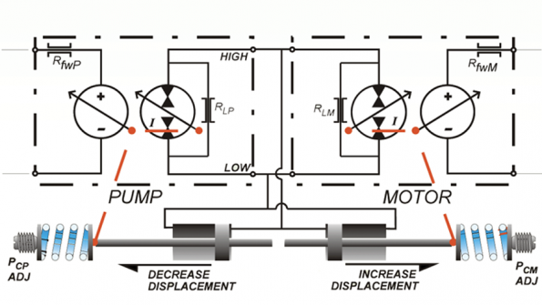

The example machine used for this study is a hydrostatic transmission (HST) with a pressure-compensated pump and motor, Figure 1. The compensators—simple pressure-area/spring-force mechanical devices—were designed and adjusted so that the motor compensator activates at a lower pressure. Then, when it reaches a pressure that causes the motor to go to full displacement, the pump compensator becomes active. It’s referred to as “sequential compensation,” because one compensator activates immediately after saturation of the other.
This configuration results in a motor speed-torque characteristic known as a constant output power drive. The aim of such a transmission and compensation method is to prevent prime mover lugging.
