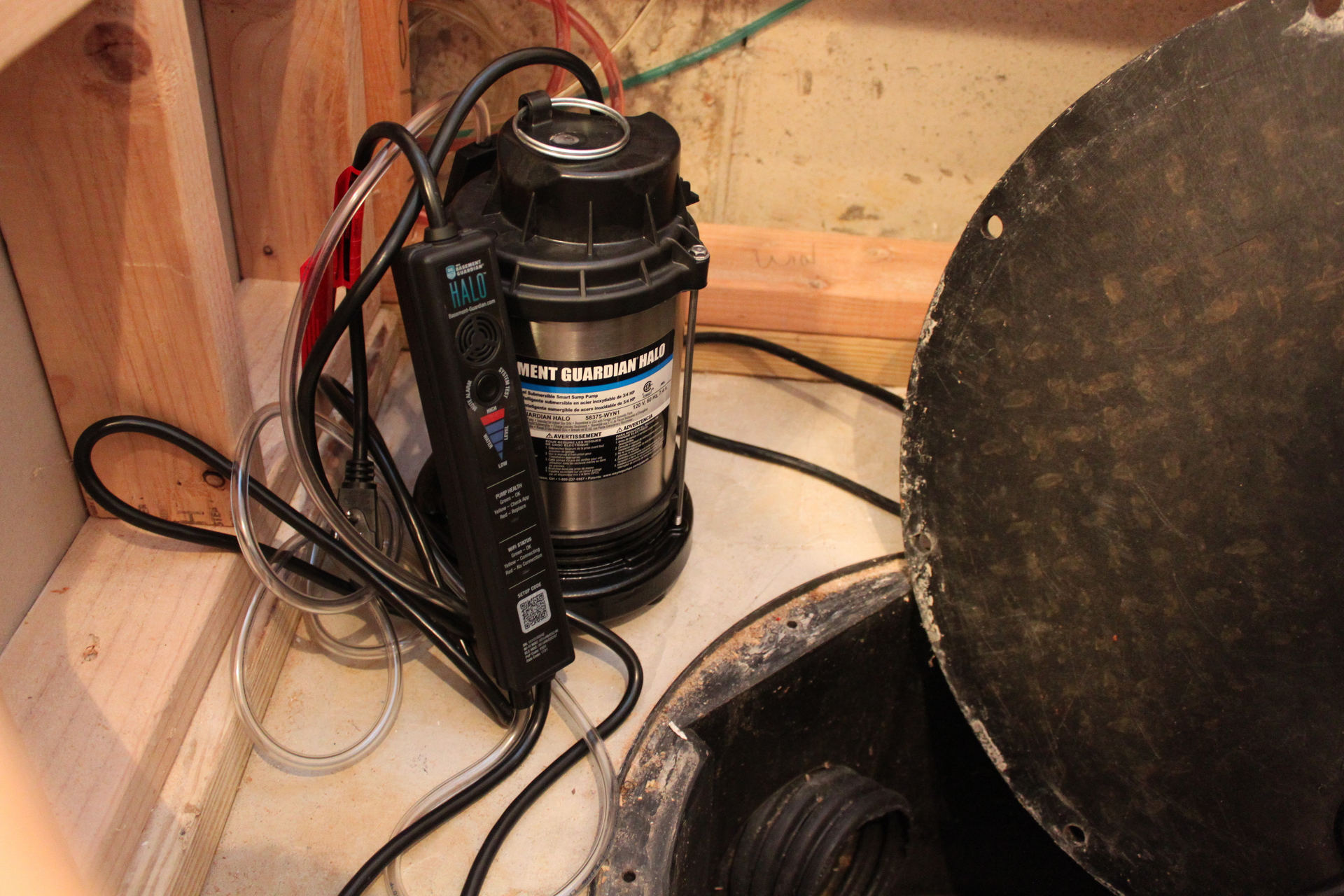

The result was the Wayne Basement GuardianHALO—a smart sump pump that is compatible with Alexa voice commands and can provide consumers with an app-based monitoring of sump pump health, rain or shine.

Wayne officials noted in a press release that over time, a sump pump’s electrical insulation and seals will break down and the pump won’t work. When the sun is out, of course, it’s hard to tell the difference between a broken sump pump and one that simply isn’t needed. The Grid Connect’s IoT controller constantly analyzes electrical signatures from the pump’s components and predicts problems and alerts the consumer when there is a problem.
