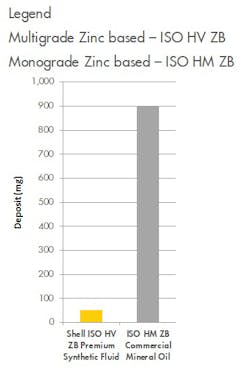

ASTM D7873
A third test for sludge, the ASTM D7873 Dry TOST test, is typically used for turbine oils rather than a hydraulic fluid. It indicates a lubricating fluids sludge and varnish forming tendencies by measuring its oxidative and thermal stability when heated to 120°C (about 250°C) with catalysts, but in the absence of water. 120°C might seem high, and typical hydraulic systems do not get this hot, but subjecting hydraulic lubricant to this test can help uncover any potential thermal stability issues. Technicians measured the sludge level according to ASTM D7873 after 1,008 hr into the test.
Quantifying the results, the sludge measured for the new synthetic zinc-based lubricant was statistically less than that formed by the commercial mineral oil. This data underscores the fact that if formulated carefully, zinc containing fluids can reduce or prevent sludge formation properties.
