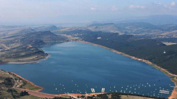

Spanning 112,000 acre-feet, Carter Lake is an impressive reservoir for the Carter Lake Hydroelectric plant in northern Colorado.
