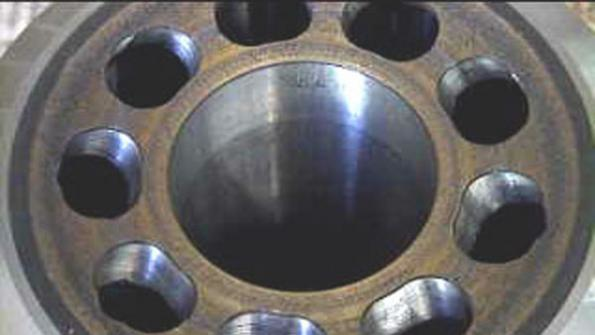

I was asked recently to do a failure analysis on a hydraulic motor that was the subject of a warranty claim. The motor had failed after only 500 hours in service, some 7,000 hours short of its expected service life. Inspection revealed that the motor's bearings had failed through inadequate lubrication, as a result of the hydraulic motor being started with insufficient oil in its case (housing).

After this hydraulic motor was installed, its case should have been filled with clean hydraulic oil, prior to connection of its case drain line. Starting a piston-type motor or pump without doing so, is similar to starting an internal combustion engine with no oil in the sump - premature failure is pretty much guaranteed.
Now, some of you may be thinking that the case of this motor should have filled itself with hydraulic oil through internal leakage. In most instances it will, but not before the motor or pump has been damaged! And this damage may not show itself until the component fails prematurely, hundreds or even thousands of service hours after the event.
In this particular example the warranty claim was rejected on the basis of improper commissioning. And as a result, the customer was lumbered with an expensive repair bill. So as you can see, failing to follow proper commissioning procedures when installing hydraulic components can be a costly mistake. And to discover six other costly mistakes you want to be sure to avoid with your hydraulic equipment, get "Six Costly Mistakes Most Hydraulics Users Make... And How You Can Avoid Them!" available for FREE download here.
