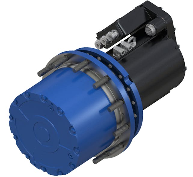

As mobile machine builders approach drivetrain electrification, a major concern is balancing the need to deliver enough torque to drive the machine against the need to make the most economical use of electric power. One tool that’s critical to solving this challenge is gearbox technology. Suppliers like Bosch Rexroth have experience building compact, high-performance gearboxes that combine space-saving designs with high-power density and match the gearbox ratio and the hydraulic motor.
