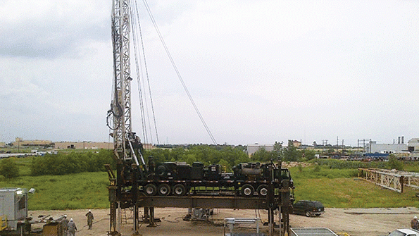

Conventional land-based drilling rigs comprise up to 40 trucks of equipment. Costs can reach $950,000 to take down and set up again in a different location (slot) no matter how close it is. When several wells must to be drilled close by each other, the cost per well can be cut dramatically by moving the drilling rig from slot to slot. Walking rigs were developed for this reason. They can move up to 150 ft at up to 100 ft/hr, rotated, and located over a series of wells as required.
A series of hydraulic rams lifts and moves land-based rigs from one location to another, saving time and money over dismantling and reinstalling each rig.
Walking rigs lift the drilling section of the rig and make it mobile. Weighing up to 500,000 lb, and fully laden with racked drill pipe, the rig’s movement has to be carefully monitored and controlled. With sometimes as many as 14 hydraulic cylinders controlling different aspects of the movement, the cylinders’ electronic feedback control system leaves no room for compromise. The cylinders used in the rigs are actually rams—the rod diameter is the same as the piston diameter. By their design, rams are single acting, so fluid pressure extends the cylinder’s rod, and weight of the rig retracts it.
