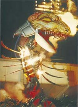

To give this monster the look of a “Technoid” — part living organism, part machine — many of the hydraulic and mechanical elements were left exposed: a rare instance where viewers can actually see fluid power at work in an entertainment application. Even though the show in which this monster appeared has completed its run of several months, a spectacular fountain from the show continues to dazzle guests every day at EPCOT Center.

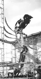

Modified John Deere 940D excavator serves as main structure for monster. Hydraulic system was custom-designed by Disney engineers for this application.

The backhoe comprised the lower body and the torso of the monster. The joints worked much like a shoulder at the base, an elbow in the middle, and a wrist at the top. Lenz revealed, “We figured the backhoe’s pivot points could take any side loads generated, but an engineer verified every structural element that we were using. I also was involved in determining the static and dynamic loads simply because these figures were needed for designing the hydraulic system and selecting components. If we weren’t satisfied with the integrity of any material or element, we redesigned that particular component.
“I designed my own redundant hydraulic system to integrate with the John Deere backhoe structure. I took out everything hydraulic that came on the structure and put in my own system, including cylinders and proportional valves. One of the first things I did was make real rough estimates of cylinder size, because the cylinders would dictate the size of all other hydraulic components in the system. We knew what the structure would basically look like, and we had some data on the masses of the head and the John Deere elements.
“The cylinders carried the longest lead time of all the elements, because they needed some modifications for mounting. I decided on NFPA-style [tie-rod] cylinders, because they are so readily available. We might have to wait to have modifications made, but we wouldn’t lose any time waiting for the cylinders themselves. After getting a rough size of the cylinders, I verified dynamic loads. To do this, part of our team locked ourselves in a room with representatives from the hydraulic component manufacturers and distributors to grind out the specifications. The cylinders could then be resized based on these dynamic loads. From that point on, everything almost fell right into place. We didn’t have a day to waste, so once I finished calculating dynamic load and sizing the cylinder, I passed my data on to the manufacturer’s rep, who would verify the size of the valves based on the speed, flow, and pressure. It worked very well, almost like an assembly line.”
