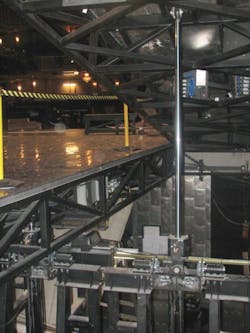

The hydraulic system drives several different types of stage platforms. Farthest downstage are three scissor lift devices that, from the basement, will drop a 10-ft by 30-ft area of the stage down 10 ft and completely out of site. Although this stage is in three sections, which sometimes operate separately, Parker D91FH hydraulic servovalves and finely tuned software allow it to appear to travel as a single platform when called for. One of the lifts can propel the Spider- Man character vertically at an impressive 4 ft/sec.
Stage platform cylinders afre equipped with mechanical rod locks that prevent unintentional movement by releasing only when supplied with pressurized hydraulic fluid.
Each lift has two cylinders mechanically linked to each other within a tight space. The close quarters prevented equipping the cylinders with mechanical rod locks, which are used to hold a cylinder∏s piston rod in place if a hydraulic line ruptures. Instead, a custom-designed counterbalance valve manifold serves each pair of cylinders. The counterbalance manifold ensures that the lift will hold position if a hydraulic line breaks.

A second type of stage platform consists of three 30-ft long ramps that extend downstage to upstage. The ramps lift in a raking effect ∇ meaning that as the back of the ramp lifts up, it also moves toward the audience. Six 3.25-in. bore tie-rod cylinders with 2.5-in. rods and 114-in. strokes operate the ramps. Analysis on rod column strength was a critical factor in design due to the lengths of the rods and the heavy loads on the ramps.
All ramps can operate together and appear as one stage lifting 14 ft upstage. Again, hydraulic servovalves and controls designed into the system by PRG Scenic Technologies bring the stage to life and make the highspeed movement of four individual stages seem like one. The cylinders are Parker Type 2H, which come with SAE O-ring ports as standard to provide leak-free operation. Each also contains an integral magnetostrictive linear position transducer from Balluff to provide continuous feedback of cylinder position. Finally, a rod lock fitted to the front flange of each cylinder holds its piston rod in place once a platform reaches its set position. The controls
