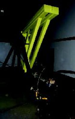

SMACR functions like a teeter-totter. The actuator maintains control of the mass that simulates the load of the cockpit/cabin it must handle when installed on the customer's motion platform.

Servo Kinetics Inc., Ann Arbor, Mich, has developed a sophisticated testing process for simulator actuators. Called the Simulator Motion Actuator Certification Rig (SMACR), it is a dynamic test machine used for the certification of flight simulator servo hydraulic actuators. It is also the largest test rig of its type in the world, having a maximum slug weight capacity of 45,000 lb, and can test actuators with strokes to 80 in.
