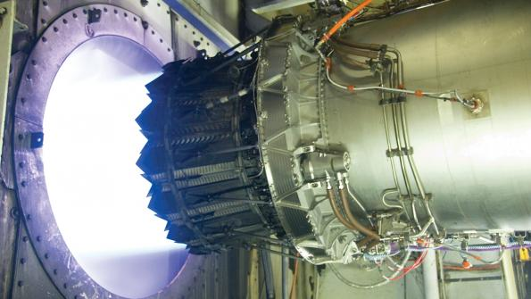

A GE/Rolls Royce F136 alternate engine used on the F35 Lightning II Joint Strike Fighter is being tested at maximum thrust conditions. The augmentor (afterburner) performance and operability is being tested over a full envelope of altitudes and speeds. Click on image for larger view.
