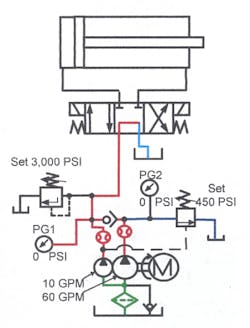

In Figure 15-9, a fixed high-displacement thru-drive pump, coupled with a low-displacement, pressure-compensated pump, creates a different kind of high-low circuit. This circuit provides fast travel and then maintains clamping pressure for extended periods with little heat generation. The circuit operation is the same as Figure 15-8. It requires no special electric controls because the unloading valve automatically dumps the high-displacement pump at any pressure above 400 psi. The low-displacement’ pressure-compensated pump reduces energy cost and heating. This pump arrangement takes the place of a large pressure-compensated pump in certain applications.
Fig. 15-9. High-low pump circuit to operate clamping cylinder

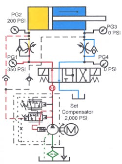

To control the speed of an actuator while generating little or no heat, try the circuit in Figure 15-16. A variable-displacement pump controls cylinder speed fairly accurately while using minimum power. As the cylinder strokes, pressure in the system is only what it takes to move the load. All pump flow goes to the cylinder so the only wasted energy is from component inefficiency. A setup like this operates continuously without a heat exchanger. The oil temperature may rise 15 to 25 degrees above ambient temperature only when cycle rates exceed ten or more per minute.
Fig. 15-16. Variable-displacement pump circuit for speed control
The circuit in Figure 15-17 is a typical pressure-compensated pump setup. This circuit allows multiple cylinders to run separately or together. When the cylinders cycle simultaneously, add flow controls to restrict the actuator that meets the least resistance.
Fig. 15-17. Typical pressure-compensated pump circuit
Oil heating can be a problem in pressure-compensated pump circuits. With the pump set at high pressure and/or if flow controls are used in the circuit, energy losses produce excess heat. The efficiency of the directional valves also is a factor. Because the system maintains maximum pressure most of the time, leakage at valve spools adds extra heat.
Pressure-compensated pumps often fail prematurely with high actuator cycle rate. High cycle rates work the compensating mechanism rapidly and resulting pressure spikes can cause part failure. A small accumulator at the pump outlet smoothes the compensator shift cycle, reducing pressure spikes and extending component life.
Fig. 15-18. Load-sensing pump circuit
One way to overcome a heating problem is with the pump in Figure 15-18. When the cylinder cycles, this load-sensing, pressure-compensated pump never allows system pressure to go more than 150 to 200 psi above load demand. The pump constantly senses the load and compensates at that pressure plus the load-sensing spring rate. Load sensing usually eliminates the need for a heat exchanger — even on a system with flow controls.
Run a sensing line from each port in a multiple-actuator circuit. The different feedback lines meet at the pump’s load-sensing port with a check valve to isolate them from each other. The pump always sees the highest load in the circuit and sets output pressure accordingly. A meter-in flow control circuit is the only way to control the actuator. With over-running loads, use a counterbalance valve to keep the actuator from running away.
