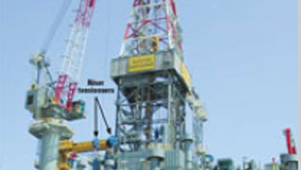

Riser tensioners being installed on a drilling platform. By changing the distance between sheaves, the tensioners compensate for wave-induced movement of the platform to maintain constant tension on the cables supporting the riser that extends from the platform to the sea floor.

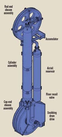

A Shaffer-type tensioner consists of a cylinder and accumulator with a sheave assembly at both ends. It maintains constant tension on the cable by extending or retracting to change the distance between the sheaves as waves raise and lower the drilling platform.

A riser line tensioner compensates for wave-induced motion of a drilling platform by extending or retracting to change the distance between the sheaves mounted at each end. The cables support a tubular steel riser that extends from the platform to the sea floor up to 10,000 ft below.
