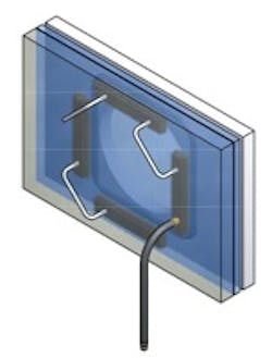

Figure 1. When the blue door slides into place, four inflatable actuators — arranged in a rectangular pattern — expand to seal the door in place.

Example 1: Inflatable actua-tors serve as automatic door seals for environmental chambers, processing vessels, sterilizers, and flood barriers. Typically, Figure 1, the door slides into place along a track; then the bladder actuators, mounted to the side and arranged to match the outline of the door, expand to press it laterally and seat all the seals. With a single pressurization, the inexpensive actuators exert a surprisingly high, uniform force all around the door.
