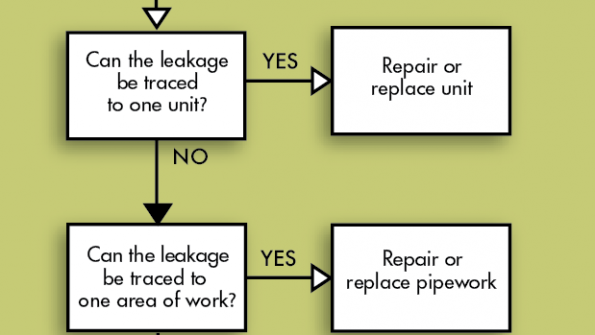

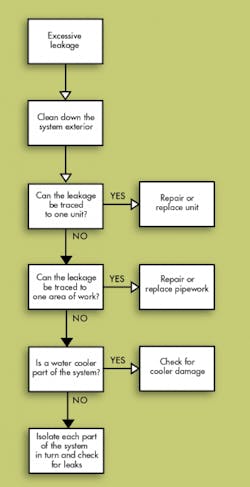

Figure 9 – Troubleshooting procedure for hydraulic leakage problems.
There are two types of leakage:  external and internal.  Because internal leakage (inside components) is a complex topic all its own, this discussion is limited to troubleshooting external leakage.  Monitoring external leakage is fairly easy, Figure 9; stopping it is not difficult; but preventing its recurrence may be a challenge.
